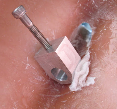

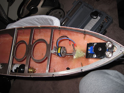

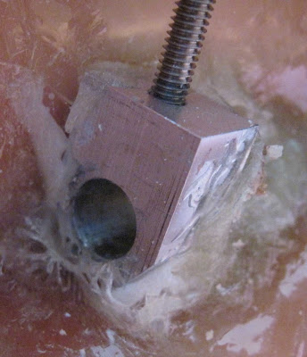

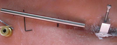

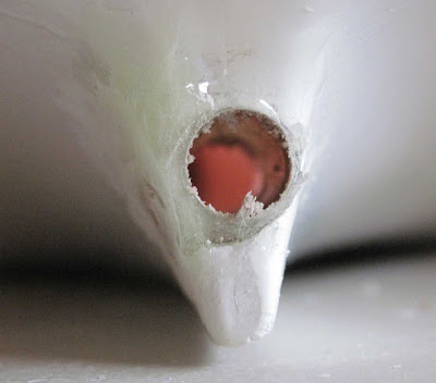

And now for some more pictures....  I am taking my time on this build, with the intention of having a ship that can be easily refit with new hardware on all components that have any probability of wearing out.

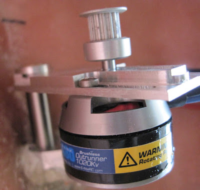

For starters, the stuffing tube is molded into the hull, but it is removable.  the aluminum block with a bolt (to be replaced with setscrew soon enough) mounts the stuffing tube to the hull.  unscrew the bolt by half a turn and the stuffing tube's position can be modified or it can be completely removed and repaired/replaced if necessary.  the stuffing tube itself is3/8" OD .245" ID 304 stainless steel with oilite bronze bushings pressed in.
http://lh3.ggpht.com/_iPCa2wo2FlY/S274bN1oQcI/AAAAAAAABYM/IlKO9Jzkh28/s400/IMG_0024.jpg

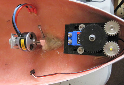

The motor is mounted directly to that stuffing tube.
And the gearbox for the rudders is also in place.

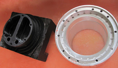

The following picture is a partly completed turret base with part of a hybrid cannon top.  The top has been tweaked from my standard design to sit in the turret base and be held in while allowing rotation.  the holes around teh aluminum turret base that are near the ID are all 4-40 tapped holes.  there is a tab on the cannon so that if you put the tab between two adjacent holes with setscrews, the turret is locked in place.  those holes allow for cannon placement every 15 degrees.  One can also run the setscrew into a not yet machined dimple in the middle of the tab, giving a fixed cannon placement every 7.5 degrees.
Now if one does not put any setscrews in, the cannon is free to rotate 360 degrees.  what my plan is, is to have the setscrews in at the end of travel + some amount...  and a friction connection between the cannon and teh driving servo.  If a cannon is impacted by another ship, it will slip on the servo until the tab on the top of the cannon hits one of the stops.  Now to recenter the cannon on the servo, just rotate the cannon by servo to both extremes, as the servo will try to overdrive one of the extremes, the stop will prevent the cannon from overdriving, and teh cannon will slip relative to the servo, resetting itself where it should be relative to the servo.

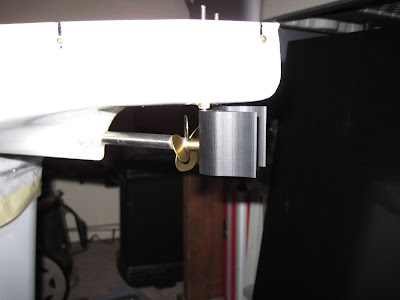

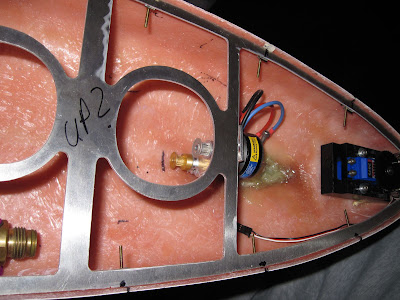

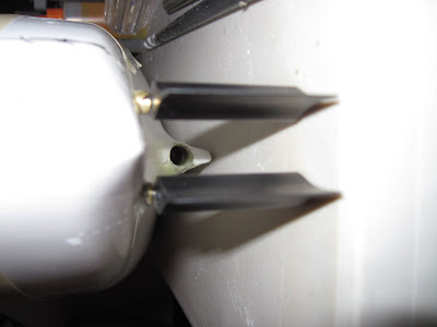

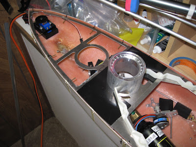

The rudders on the test install
From SMS BADEN
rudders to stuffing tube hole
From SMS BADEN

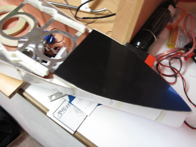

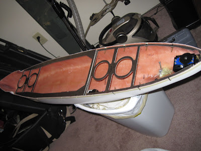

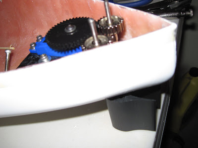

Test fit of the metal decks... need a stiffnin rib at one spot, but that is readily accomplished.
From SMS BADEN
prop + rudders
From SMS BADEN
running hardware
From SMS BADEN
From SMS BADEN

With about a 1000 rpm per volt on that motor, what voltage are you running in it Greg. In my next ship I have been thinking about trying a brushless setup, due to the size, and weight savings in a destroyer.
What class is that motor equivelent to in a brushed motor? From the pictures, its hard to tell, but it looks like its equal to a 500 series maybe. Will it have enough power to run a single shafted boat, without burning it or the ESC up, but you have most likely already looked into that, I was just tryin to get some idea's asking myself.

that motor is a 480 class motor by the case size... and I have decided to run a 6V system with a separate (and small) 12V secondary system to run the solenoids on.
I am not necessarily convinced that the brushless motor needs to be the same class as the brushed motor... mainly because of how fast the efficiency of the can motors drops off from the BEP (usually about 75% efficient there). Unfortunatly, there are really no available datasheets with the efficiency and other curves to compare with the mabuchi curves that are available. My feeling (subjective, based on experience) is that the outrunner motors, being far torquier than the brushed or standard brushless motors, are probably the way to go.
I ran this motor on my tirpitz before I sold it to Justin, so it should be able to drive this boat just fine.
I plan on using a castle creations mamba or sidewinder ESC, or if justin's Mtroniks brushless esc works perfectly, that one. One has to waterproof the castle creations esc's, but I have one that I have encased /potted in an aluminum block that I have used for several years now. One reason that I like the castle creations is their castle link software, as it allows one to change via computer more parameters than you can change without having a computer interface... for example, I can set how it transitions to reverse, I can change how the transmitter stick position relates to throttle, set any low voltage cutoff I want to set, etc.

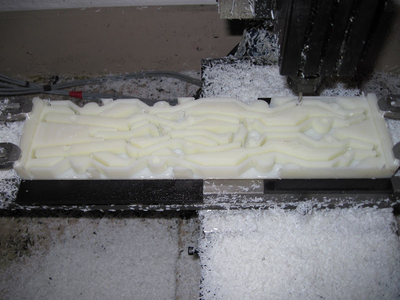

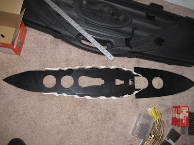

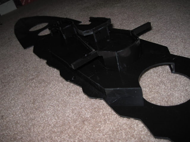

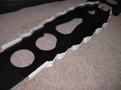

pictures of casemates and deck and subdeck.  there are  a few sections of the casemate that got a bit chattery and will have to be replaced with flat panels, but that is easy enough to do with abs, as acetone works as a chemical welding agent....

I really like the ABS, cuts like butter, so long as you fixture it even remotely well

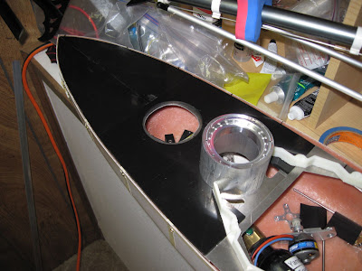

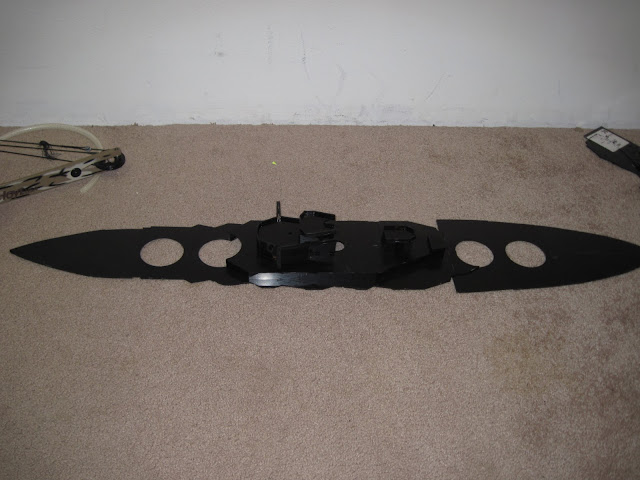

It's been a while, but I am finally getting a chance to work on it a bit again.  Still need to build cannons, but hopefully this winter I can get her built...

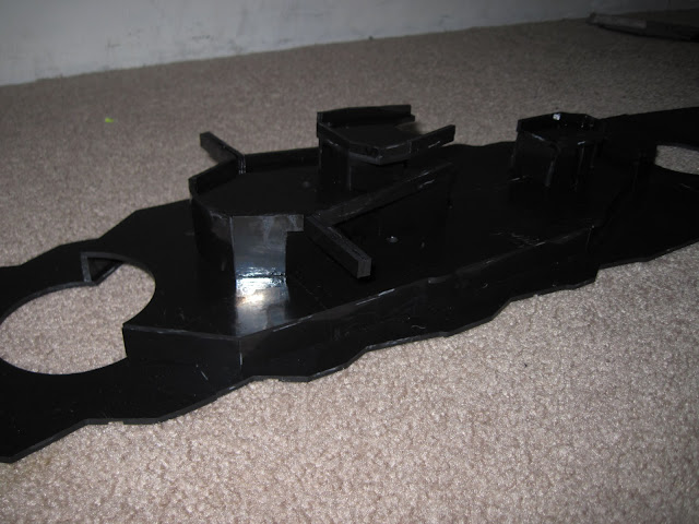

superstructure pictures.  there are a few more parts to cut...

Tug's comments about snap together stuff reminded me to put tabs that lock together on most of the part that could accept them.

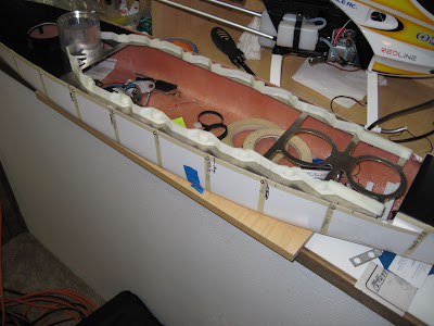

Posts:1409
21 Nov 2010 10:05 PM

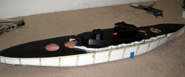

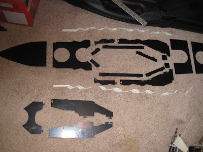

and now that the computer is fixed (finally) I have some more pictures for you...  Unfortunately, shiny black plastic does not photograph wel.
I will say that I am really liking the use of ABS as a superstructure material.  the fact that it welds together using acetone is a great feature.
