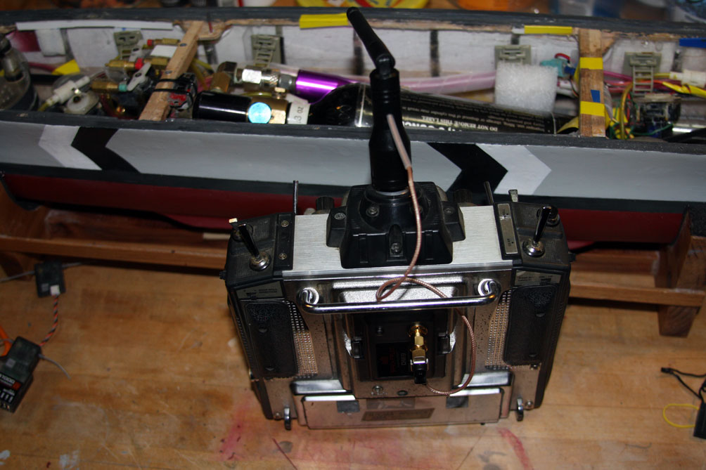

I have two JR PCM10sx 10 channel radios I bought for flying, and thought it would be cool to convert them to 2.4 GHz for use in ships. Although the radios are designed for airplanes and helicopters, there are plenty of features that work for ships.
I considered going the Hobby King approach, but decided to play it safe, and went with a Spektrum module from Horizon Hobby. It was a fairly straightforward conversion, and tested it yesterday on the pond in our Gunnery & Maneuvering event. It worked perfectly, and I'm very happy with the results.

TX Conversion
No permanent TX modifications are required to use the 2.4 GHz module, and no mods are required inside the TX case. There is a cable that runs externally from the TX module to the antenna, but it doesn't get in the way, and it's very toughly made.
To install, screw in the supplied TX antenna adapter, and then slip the 2.4 GHx antenna over the adapter. Insert the plug-in module, and screw the cable fitting onto the post.
