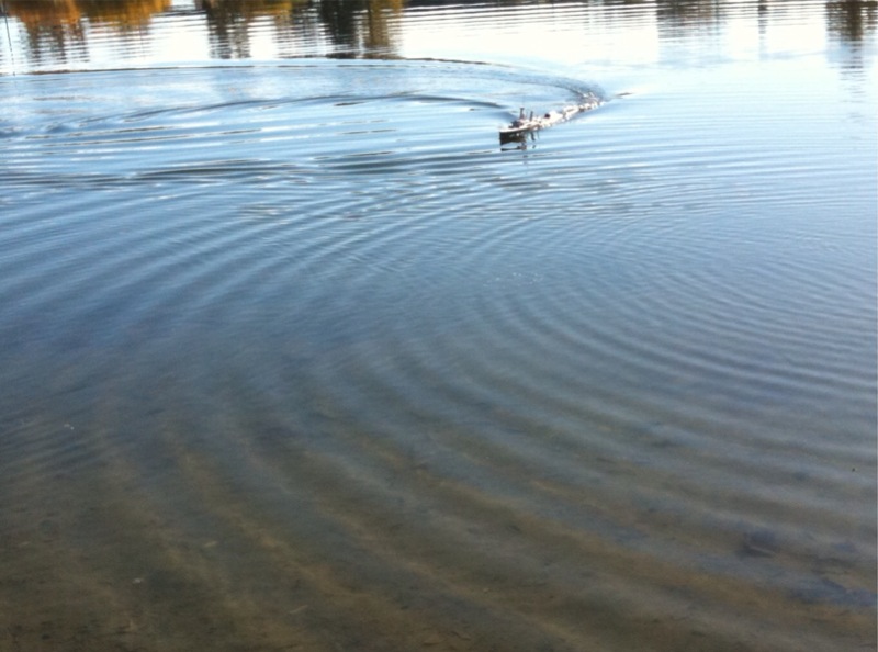

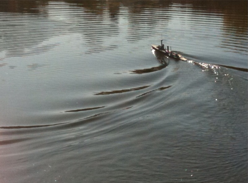

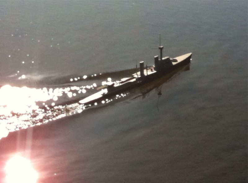

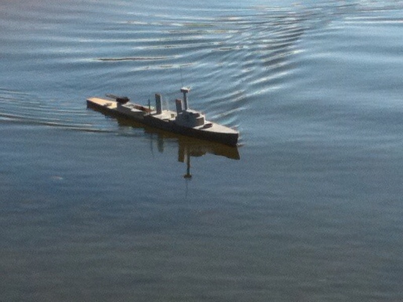

02 Nov 2009 09:32 AM
And for pictures...

Nice looking ship and a nice looking pond.

The pond is public enough we probably won't be able to use it. But it would be great.

Very nice job indeed.
Did you build this kit yourself?
I am surprised that there are not more of these sweet little ships on the water.

Greg McFaddenUser is Offline
Posts:1439
02 Nov 2009 11:12 AM
Yes. that is the advantage having a guy you know with a laser cutter... all the superstructure was laser cut. bit of a dog on turning, I will probably make a new airfoil shaped rudder for her one of these days. few details left, still needs the air system installed and a few bits on the deck installed.
