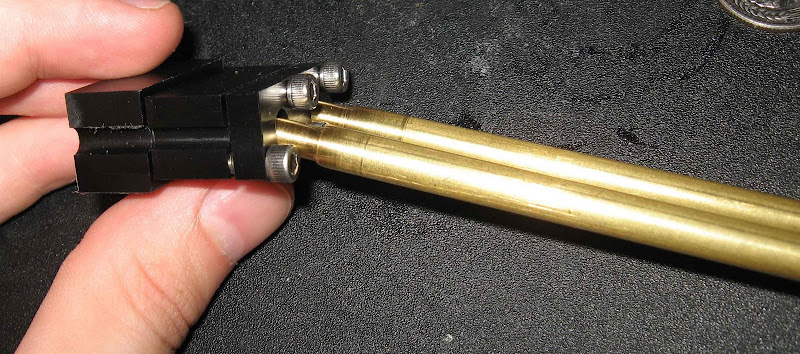

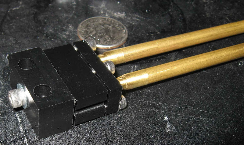

Well, I always try to do something completely different on each build or rebuild.  This is it for the karlsruhe (the pump was an evolution not anything truly new).
A breech that allows independent elevation control and has the standard IRCWCC restrictor.  it is currently untested but so far it looks like it should work well. (assuming it doesn't fail structurally.  it shouldn't but until it is tested, one never knows).  it is also small enough to fit in one of the K's turrets.  Heck, after this I have a whole host of things that will make it easier to make and align
total size of the breech is: (excluding barrels)
0.628inX1.205inX1.606in
Wreno, if you recall us chatting about elevation control a couple of years back, this is the result of that conversation.
